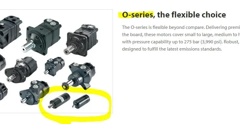

Thank you, I've already seen but... only series w and r...test vedere qui![]()
Orbital motors
The Danfoss orbital motor range is the broadest on the market. It's your safest bet for quality, durability, efficiency and reliability.www.danfoss.com
... try to write to danfoss...omr engines are identical to other brands. cylindrical ones are very simple to draw.
If you want the model ask the manufacturer with a lot of mail.

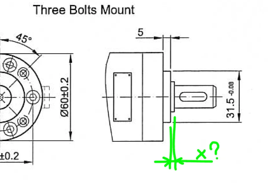

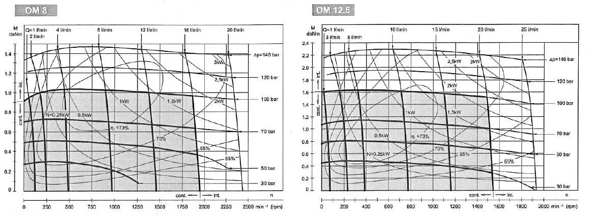

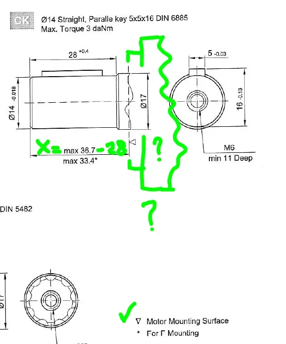

at the end of the models I need are 2 in 2 versionsIf it's not for aesthetic issues, it doesn't seem like such a difficult model to shape.
then depends on the type:
omm
omp
oml
