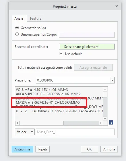

I am working on creo ptc and I would like to display the mass properties of the component without bringing back 3.0627421 e+01... At a glance, it's uncomfortable.
Is there a way to make you normally read 30.6 kg?
I would like to see it as other software with the drive and a couple of decimals without "e"...
let me know if you have to work on config.pro or other settings.
Besides, sometimes instead of the kg, it shows me the tons and I don't understand why.
thanks to all for support

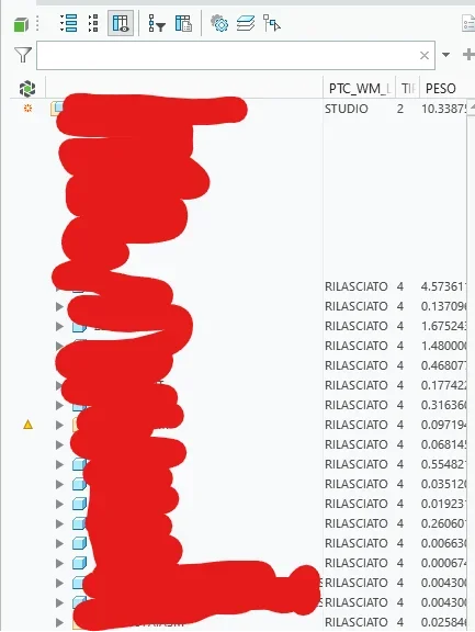

I do a little weird to see the weight in the tree of the parts.
A report must be added:
weight=pro_mp_mass
then you have to add the weight parameter that will precisely display the weight value in kg
then you have to edit the view of the columns and add that of the weight under param model.
I didn't do it all I could have missed a few steps I don't know.
