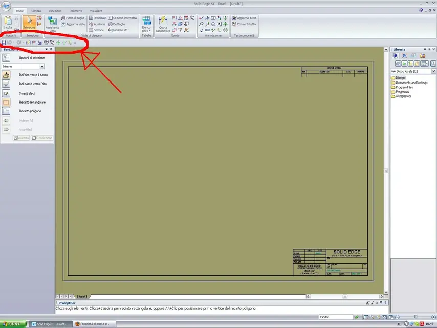

hello to all
probably the users of st already know it, but it is possible however to persalize the menus in the various environments (par, psm, asm and dft), not so flexible as for the previous versions of if, but at least in part you can manage to search sometimes spasmodic of the various buttons, which among other things are not even equal as size.
Moreover, I had followed various discussions that you had made about the working method (synchronous technology); However, it is possible to combine both working methods, classic and st, popping up in the context menu the option that activates the template files of both versions, even you can only activate the classic option.
no fear, however, I did not break a spear in favor of st, even with regard to the "percepisco" a little ostico. :biggrin:
