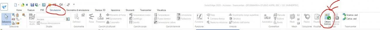

at the time of creation of the mesh, launched the command, this is not performed.

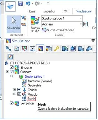

here the steps I use to create the analysis:Immagine.pngin the feature tree, if you pass over the mesh writing, the message appears:
"This feature is currently hidden."
if you launch the resolve command, the nastran error appears.

question, has the mesh been realized and is it only hidden or does it not exist?
Hello be_on_edge.
Thanks for the answer.
no mesh is not realized, it does not exist.
the command is as if it was disabled.
I also add that it initially worked the simulation, so I managed to do my studies. Then at some point, that's enough.

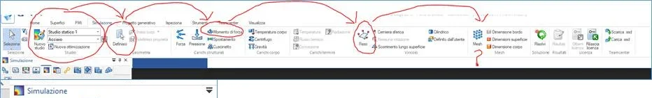

by right-click on mesh, don't you have a chance to create it?
I just tried., both on the features tree and on the ribbon bar.
nothing that allows an alternative to the creation of mesh.
this thing is strange; It would imply that no one can do simulations and it is not possible that siemens does not solve it.

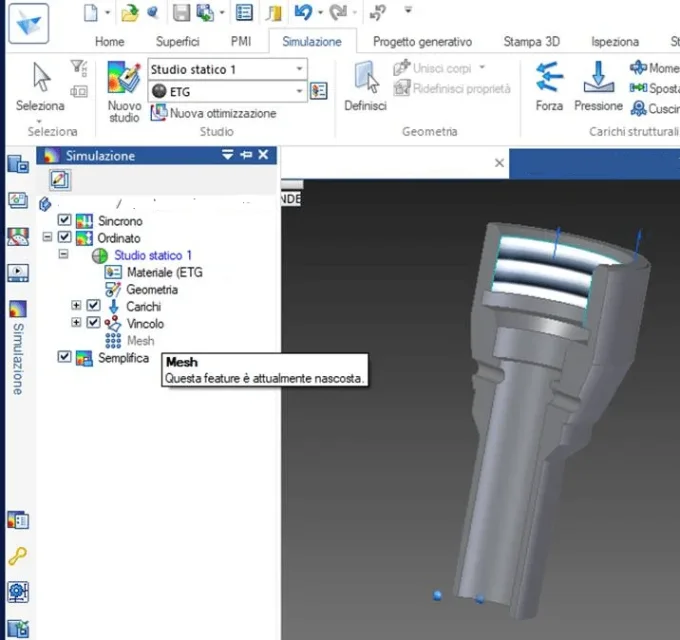

if it can help, I also add that, in the office we have eight classic licenses and a premium float.
who needs to simulate: frees its classic and clears the premium license to those who upload it first, loads the premium and has to get the license.
Immagine3.webpoperating so, in two stations the simulation works on the other not.

just tried with premium license and meshatura works.
I would begin to isolate the pcs on which it does not work and understand what differences they have compared to those on which it works well.
