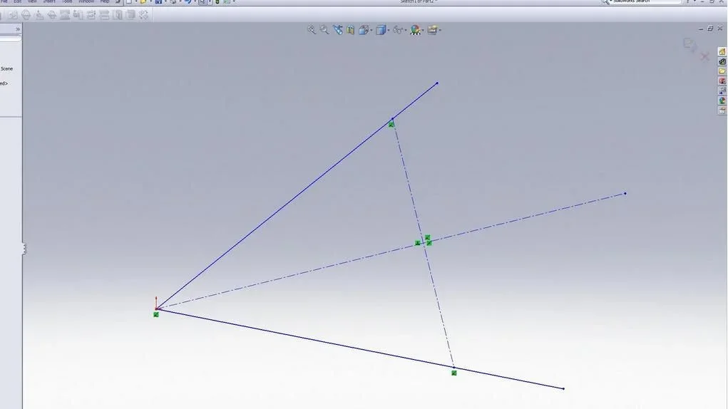

that you know, there is the "bisettrice" command in sw?
that is, given two lines, is there a command to generate the line to them central and parallel?
in the table is present in the notes (as axis), but in the sketch?
Thank you very much. :-)

provided that the bisector of two straights forming an angle cannot be parallel to any of the two straights, not being the command as in acad, you can quickly overcome the lack by passing a straight from the common point of origin of the two straights or from the point of intersection of their extension and the central point of an arc that has as center the above described and starting points and end lying on the same intersection.

if you have two defined lines should simply draw the axis and then selecting the three lines give the symmetry bond. also applies to bisector
