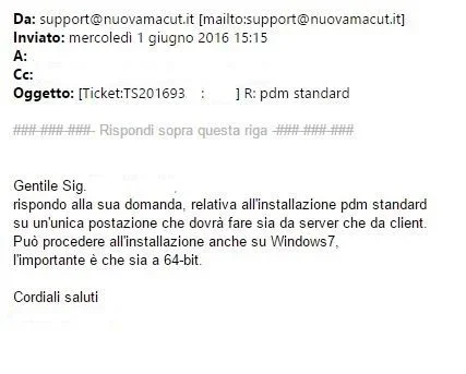

I have answered those of solidworks customer support, you can also install on windows 7.

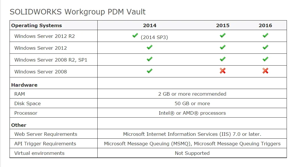

on the solidworks site give as operating system for server-side installation, only windows server.
client side can be used 7, 8.1 and 10

risposta pdm standard.webpI read it too, but they told me that you can. windows 7 also does as a server in this case.
If they say so. .
Basic windows server 2008r2 corresponds to windows 7, so there should be compatibility.
