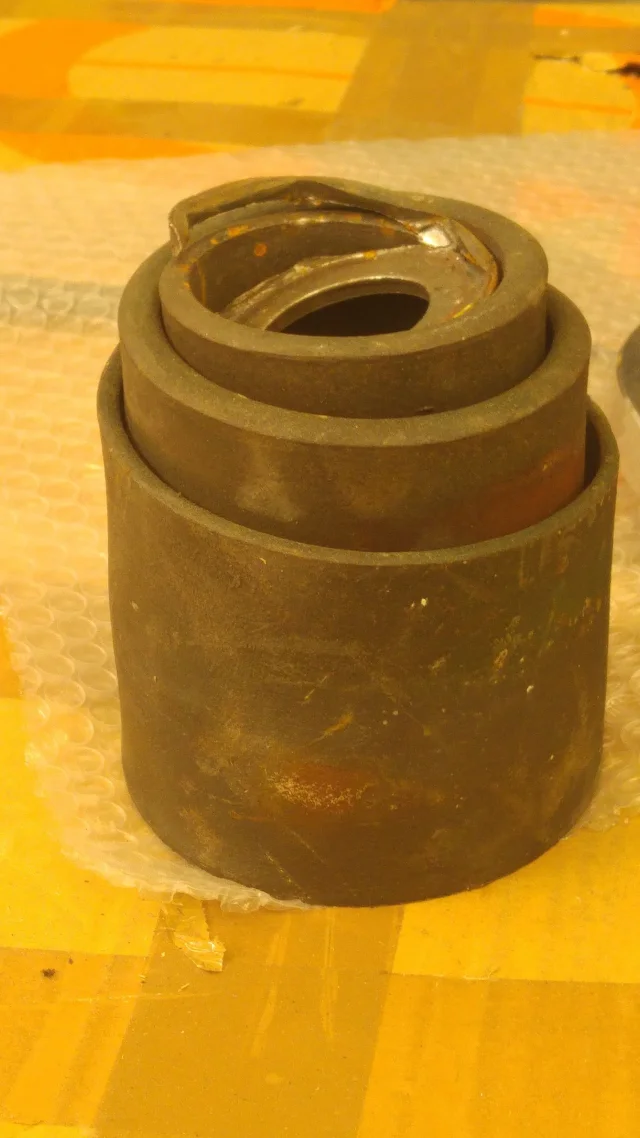

save we have 2 springs that have the function of parastraps on a catenary that transports coils from 20tons enlivened by an 11kw motor
the springs in question have broken and I cannot find, seen the enlarged ones I have, of the helical springs of equal characteristics.
the current springs are made by a flat coiled band with 40 mm of 115 mm length of 150 mm an excursion of 50 mm (total run 100 mm) and a declared load of 50knewton for each single spring. The springs are studded and are supported by a steel bar of 36 mm. as a design name we torvato feder nr 270.Spring.webp
If you're in the gas barrel and don't answer the mollizers you can ask the spring machine manufacturers if they have any manufacturer to indicate.
