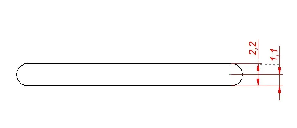

how do I delete the setting that connects the quota
created to the previous one as in the image?
practically then the odds merge and move together
It's what hates me
Usually if they insert a function, they also put the way to activate it or disable it from toolbar or settings.
if known near the icons of the quotas that are of new ones: some selected (orange-abbronzate) and others not,
I think one face to your case: Keep dynamic alignment.
It's what hates me
But why don't they leave the world as it is?View attachment 37371
I like well-ordered drawings this function has liked so much!
then, as already mentioned by wasp, it is disabled with a click
