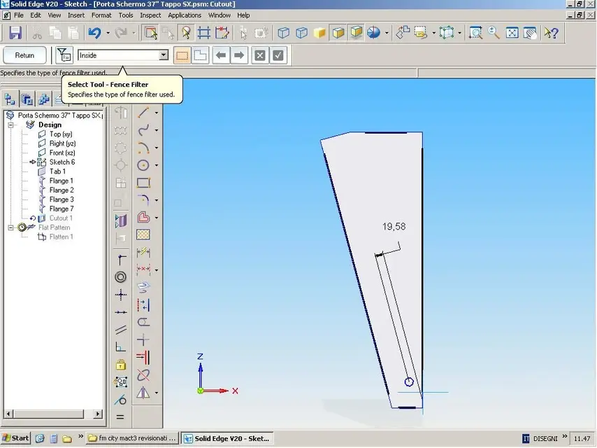

Does anyone know how to tell me why in the piece represented in the attached image I get the oblique quota instead of giving me the vertical quota between the center of the circle and the vertical side of the piece?
if you use the "device between elements" command make sure that the "horizontal/vertical" mode is selected. in your case you used it in "points" mode.
if you use "smart size" when you hit the share you don't have to hold the shift key.
