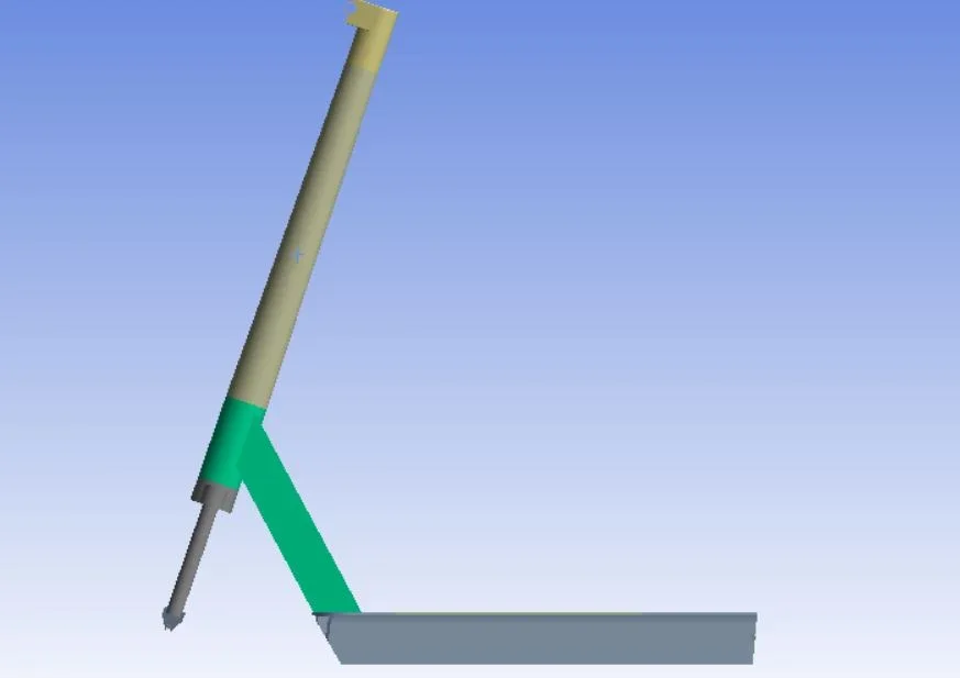

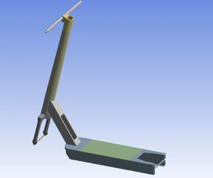

the images are attached, I modeled it both in creo and in space claim but it gives me problems when I apply force to a surface 2d

I'm sorry. the famous square 2d to which you refer, on which you have to apply your load, is that rectangle that in the image we see in “green” at the center of the gray plain.. ?
if so, basically your problem is only to delimite the area on which the load acts:
- pro solution: in the modeller of ansys performs a partition of the original plane, so that the software recognizes the central rectangle as a bounded surface to which you can apply a load;
- quick solution: take your model in clay, and extrude on your floor a rectangle of the size you want and the thickness of a tenth millimeter. when saved in step and amounts in ansys, the fem will recognize that that that is a bounded surface and that the load goes only there.
If you add more “objects” put us to your model, for a problem like this, you just go to mess up ... as it is happening.

Yes, it is the gray square; I built the sketch in space claim.
cmq since I have had this problem for a long time I have done all the simulations with the quick solution, now I try with the pro solution.
I thank you for your patience and your answers; I'm going to work!
