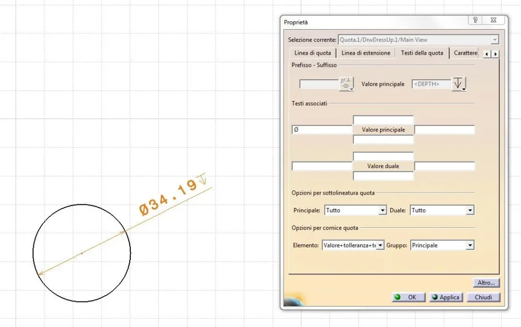

hi to all I'm listing holes in the casket that besides having the indication of the diameter also have the indication of the depth, to understand the one indicated in the image.
Unfortunately when I insert the symbol always inserts it forward to the value of the diameter and not after as I wish, what is wrong?

enters the properties of the text of the quota. then open the tab texts of the quota.
you can add the depth symbol as the default suffix (catea only allows you to choose a suffix or a default prefix).
Afterwards in the box below, insert yourself manually (painting/ctrl+v) as suffix the ø diameter symbol.
Are you sure you can add the symbol as suffix?
from me the box is blocked.
can you post the imagination of the options you described?
Yes, you must first select as a prefix the symbol with "more symbols" (the first of the list in short, which acts as a reset of the prefix).
