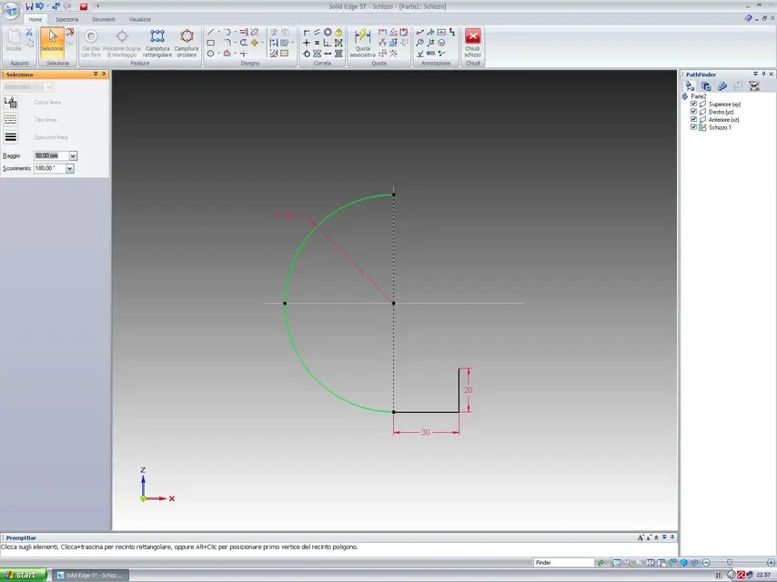

Have you ever seen that st no longer visualizes in sketches (classical mode) symbols of geometric relationship?
In practice I have come across this inconvenience, geometric relationships are no longer evident, although they are retained and recognize them, instead of constraints, dots are sometimes black sometimes blue (at least in my case).
in practice you do not know what kind of bond is active on that intersection date of lines, rather if the circle you designed is bound to the center of the plans and so on.
all the options are properly activated, I tried to restart st, set and relocate all the options but nothing.
all this happened without apparent reason and until recently everything worked correctly :confused:....any suggestion kindly?

an example image attached.

with the st always happens.......... even after the mp9, you have to reactivate the display in the tab "view"
p.s. to me also happens in draft environment.
It never happened to me, but that's the procedure to reactivate them again.

....and thank you so much, solved as you rightly said.... but they do this and I also think I understand how it happens, at least in my case.
when you are in asm environment and realize a sketch to make a rectangular sampling, on the return to psm environment or to set off.
I discovered this because I was so tired of working blind with sketches that way, that not knowing what to think, I reinstalled st (poor bad I had installed it the first time a month ago and little used)
and the subsequent reinstallation doing exactly the same previous operations occurred the same drawback.
In fact, sp9 doesn't even solve anything.
