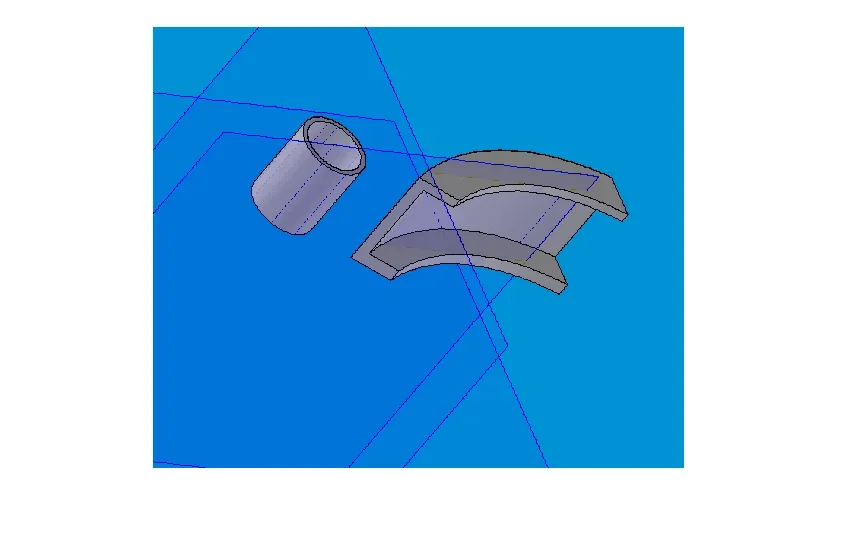

hello to all I have created 2 distinct solid parts and separated saving them as such then I opened the axieme to be able to assemble them but tells me that there is a conflict and not possible.. what should I do? Thank you.
You're a little generic.
if you have holes to be coupled, make sure that they are bound (relations and quotas) in the same way, because it is enough 0.00000001 mm of difference to send a conflicting relationship.
example if you have two plates with 4 holes lying on a circumference of 100 mm, but on the second piece quoti 'quadrato 70,7 mm' (side of the square inscribed) it is obvious that in asm you go into conflict.
