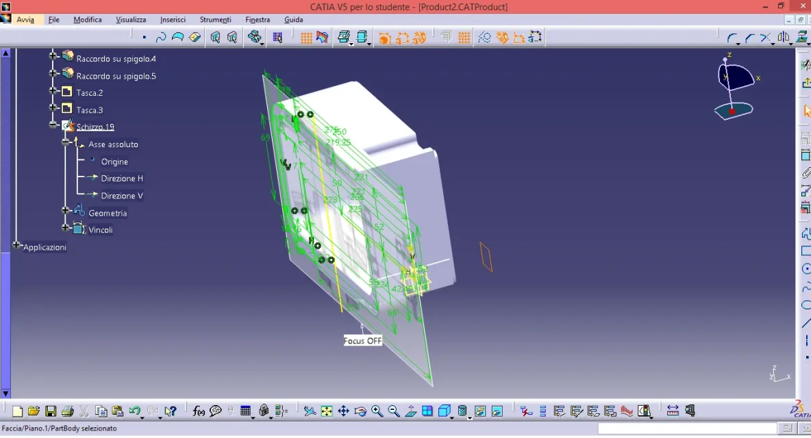

save more than a problem this is simply an acceptance of a fact (remake the sketch) but I want to remove every doubt: if I have perfectly bound a sketch regarding the absolute reference frame of the axieme (modelling top down) it is possible to translate the sketch already listed on an existing offset plan? allego photo where the offset plan is highlighted in orange
Thanks for the patience:redface:seconjda domanda.webp
left key on the sketch in the tree, under object there is change the reference of the sketch ..... clikki and then touch the plan where you want to move it.... .
If there are no particular constraints that prevent moving...... you will see the sketch moved
