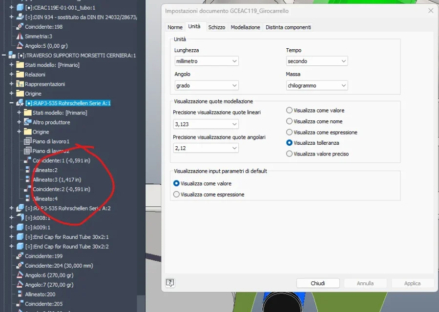

inventor 2024 keeps me giving the units in inches despite in the document settings has entered mm (see img)
You know if there's any other setting? ?
if before changing the units of measurement (pollici->mm) you have made constraints with inch measurements these remain with this unit of measurement even after making the change.
after having c ambiato unit instead you will be proposed constraints in mm
In fact I think they were measures already set on thumbs.... Moreover in another part the imp. were correct but the sheet data were in inches
solved everything thanks
