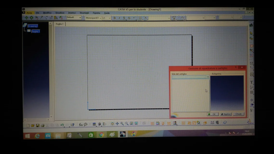

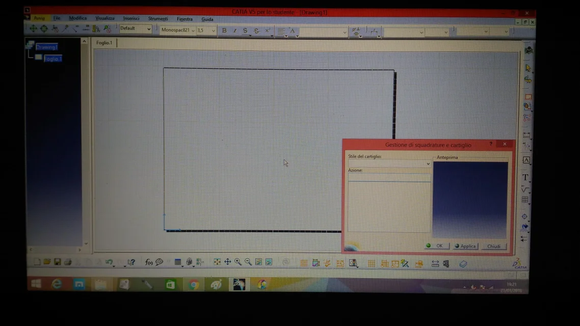

Hello going to make the table I realized that catia does not give me any model of cartiglio: how is it possible? How can I solve this?P_20180121_192150.webpP_20180121_192158.webp
the cartiglio can be inserted by:
menu/modification/sheet background/
then menu/insert/insert/insert squares and cartiglio
where it usually offers you 3 types that are generated by macros
If he fails, I think it's because he doesn't identify macros:
problems in installation?
honestly I did not notice (I followed the wizard) and the license is original students
by chance is it possible to add this "database" of the cartiglio back?
in case I can proceed?
search for macros in the system (which they are called. drawing_titleblock_xxxxxx) and then create a folder where you put them
So you're pointing her as a cat: menu > tools > options > mechanical design > drafting > background layout/view,
