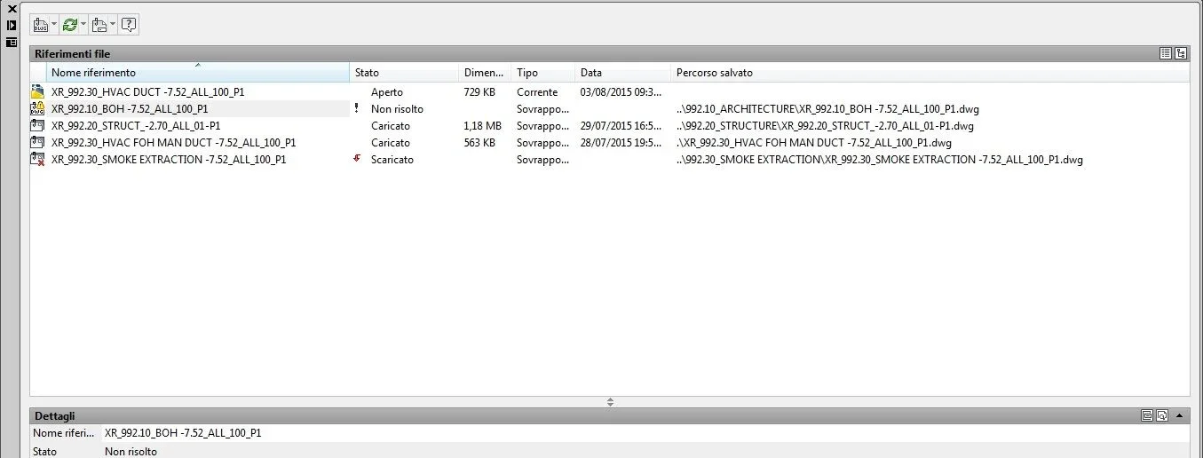

Thanks for the answer, but that's not my problem. the setting to freeze the layers use it just to see or hide the objects I need. I made the mistake he gave is unsolved. this error gives it with visretain=0, while if I put visretain=1 charge normally the reference
in which version of autocad is saved the design that "is not solved"?
if you launch the check in that design you get error messages?
are saved in 2007. He finds me 1 error and solves it, but nothing happens to my problem. :confused:
it would have been nice to know the error message detected.
what autocad you use? if you use one of the versions + recent you tried to save the file in those versions ? happens the same if you load that file as xrif in another any drawing file?
