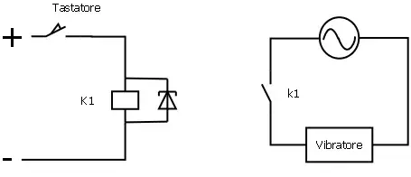

Hello everyone I am a young mechanical maintainer and I would need advice.
I have to feed a cup vibrator with a hopper that is equipped with a vibrator to facilitate the release of the pieces contained in it.
I wanted to mount a level-to-tasting sensor that either activates the hopper vibrator so as to keep the level of the pieces constant in the cup vibrator, avoiding in this way that the machine operator loses time in loading the vibrator.
Could you advise me what kind of sensor to use and how to connect it to the hopper vibrator?
I do not have free channels on the plc and install a plc only to control the hopper would not seem the case.
Thank you very much.
