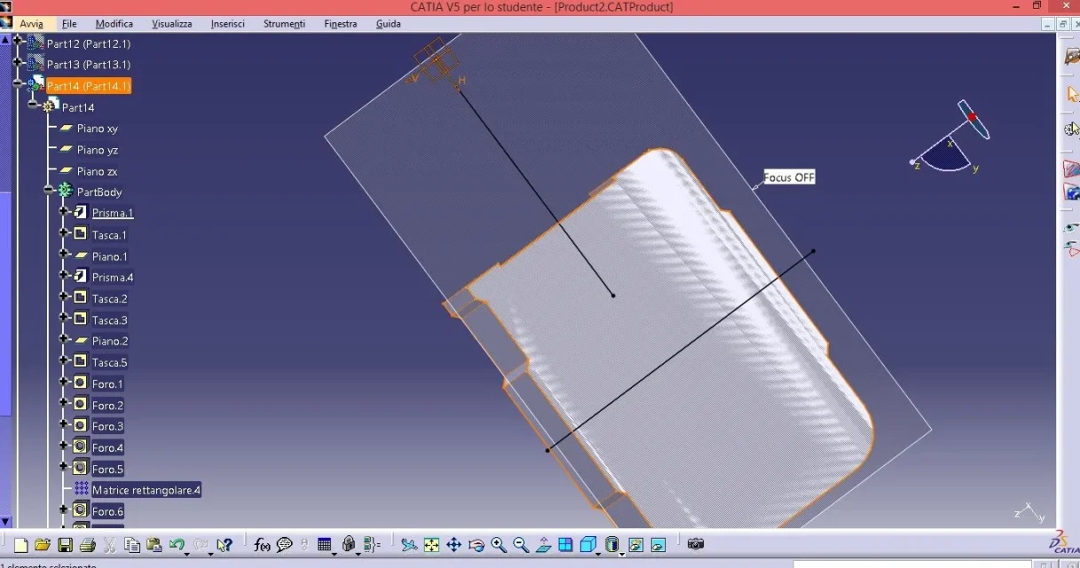

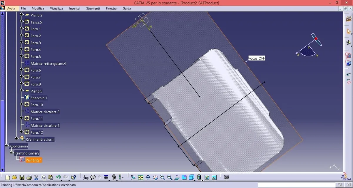

Save once you complete the top down modeling,open caty and the image I find is this:layout monochromatic grey and half of part 14 without any features applied.The most trivial things to understand what happened I tried all:
1)I checked that the image had not been erased
2)I checked that the image was in the same directory from where I call it
3)I checked if there were warnings or structural errors in the piece
4) I have rechecked the features that I still find in the tree (but I do not see)
5)I checked if I had combined some trouble with rescues (the only thing I can think is that to save piece 14 (criminal piece, which is boring me) I used the option save and non-management save..but I don't understand why then I find the features in the tree.. .
5) I even tried the method close and turn on the pc (which says it long. . )
I attach photos that perhaps will clarify better the problem
thanks in advance to all and compliments for this forum... is my salvation:wink::wink:1.webp2.webp

I have already tried... but nothing: the problem is that in a piece of the total I have the usual feature tree (which are then recognized as operations carried out) but the display with material is blocked at the first operation, i.e. "prisma 1" : a video is as if beyond that operation I had done nothing more
try isolating the catpart and see if you solve it. I saw you have a connection in context. different symbol in the logical tree
solved
the problem concerned the choice of references (it was selected internal reference to the part and not the external ones)
