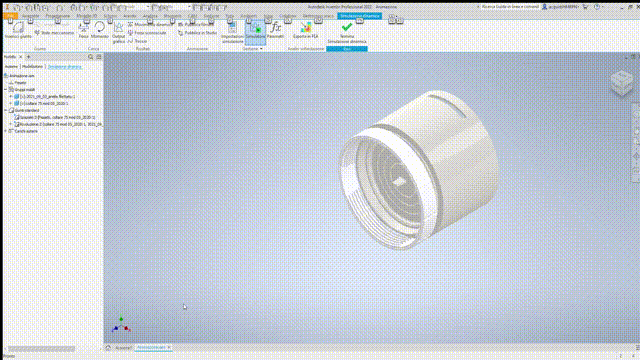

why just spins the collar and doesn't go on in the simulation?
Varuas120
Hi, I'm a newbie who just started working (3 months) with autocad and inventor.
I was told to do the animation of a collar that is screwed to an adapter, I know that with in simulation and with the joint command you can do animation but I can not. the collar turns but does not screw (it does not go ahead). What did I do wrong?video

the animation of the constraints makes it move one at a time... I think it's the same.
to make more "complicated" movements you have to go into the inventor studio environment where you can control the various movements.
If you look at this video It seems possible, at least that they are not completely different things.
in the video the axle terna is the same.
In this case, however, I would do it with inventor studio where you can animate two constraints at the same time.
Alternatively, go to the functions and attach the variables of the two animation constraints (attention to the unit of measurement that one is in degrees and the other is in mm).
