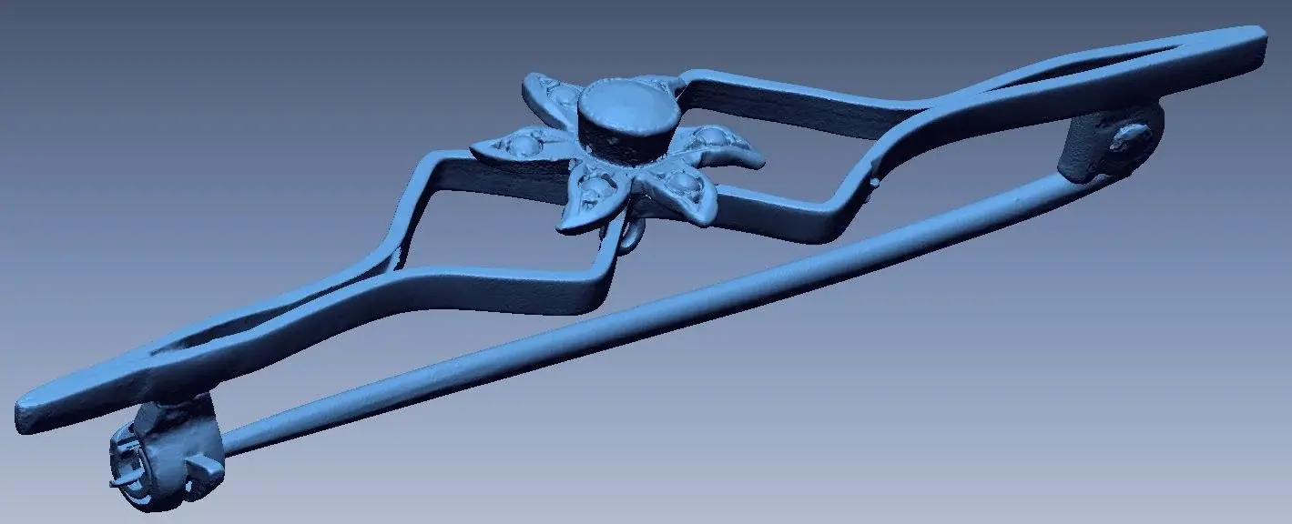

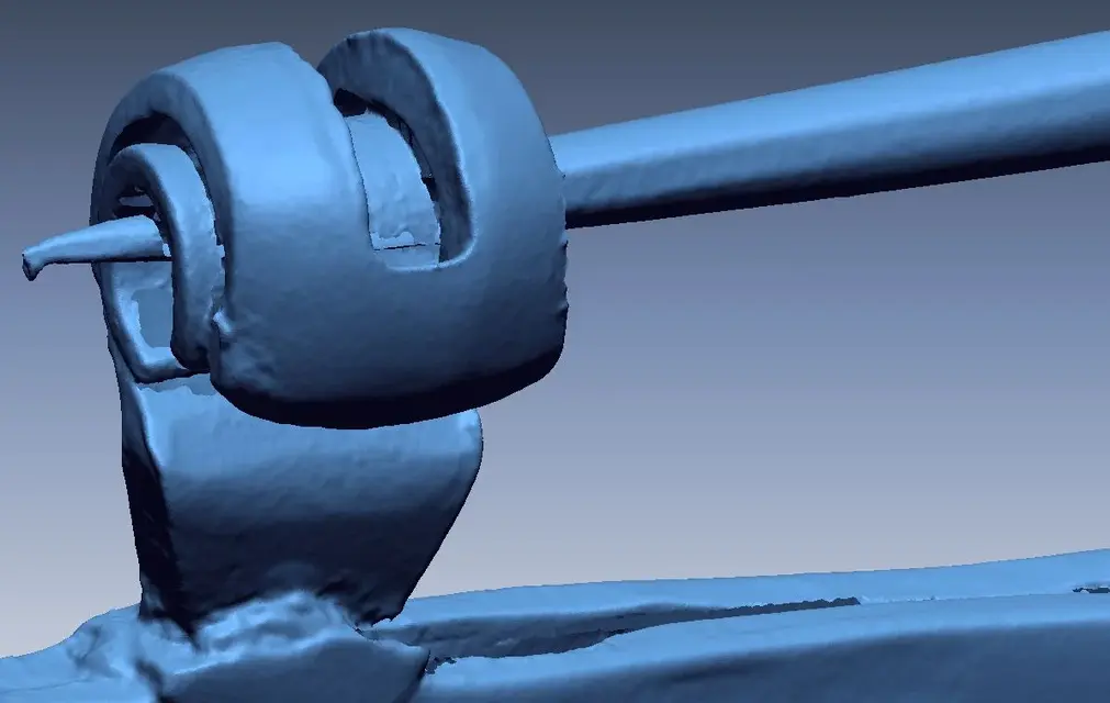

[Bleep] I attach you a couple of pictures just not to be exchanged for a miner;
rice bean can be represented by the tip of the brooch you see below
