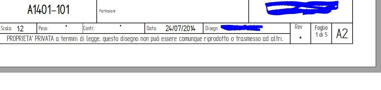

Hello, guys.
I have a problem about saving the designs and assigning the name.
In practice I created a formula on the cartiglio that relates the name of the file (in this case the code of the assieme a1401-1) with the sheet number.
FORMULA.webpso just add a sheet that automatically get the component name progressively with the sheets.FOGLIO 2.webpthe problem lies in the fact that when I go to print or save in pdf the numbering of the sheets is canceled and on each sheet remains the word "sheet 1 of 5" as if it reported all the sheets to the first.
Therefore the name of the compost always remains "01" final on all sheets and the speech made before is less.FOGLIO 1.webpIt seems strange that it does not keep the numbering of the leaves when I save all the drawings together!
in the pdf rescue options I found nothing that can solve this.
So basically, do you know a method to save/print a necklace of sheets maintaining the progressive numbering of solid edge sheets?
or do you usually make all drawings on individual dft files and then in saving you assign a new name to the drawing?
as always thanks in advance!:biggrin:

remains 1 of 5

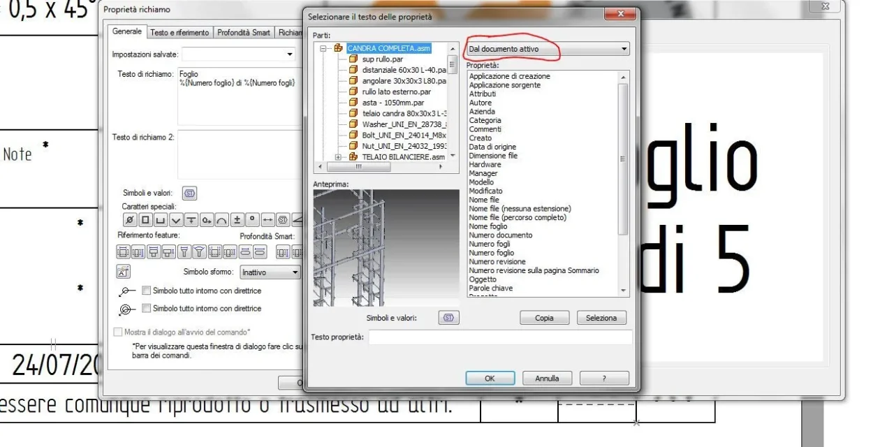

I don't understand....maybe the reference of the formula "number sheet", maybe I don't have to put active document but "vision drawing" or other I don't know.Cattura.webp

these are the reference codes for the design name and for the numbering of pagesrichiamo.webp
foglio.webpfor the hunter post instead, the problem I have when I save everything in a single multifoil pdf, especially according to the sheet where I start the multifoil saving (for example the second sheet) applies the same number to all other sheets (so the code of all components will end with 2).
instead if saved individually the files all regular; I put on the sheet, save or mold and automatically apply the code to the drawing and the sheet number.
rightly if I can do this with a single multifoil rescue would be a nice saving of time!:cool:
I've been using it for years. sheet %{sheet number} / %{number of sheets}
