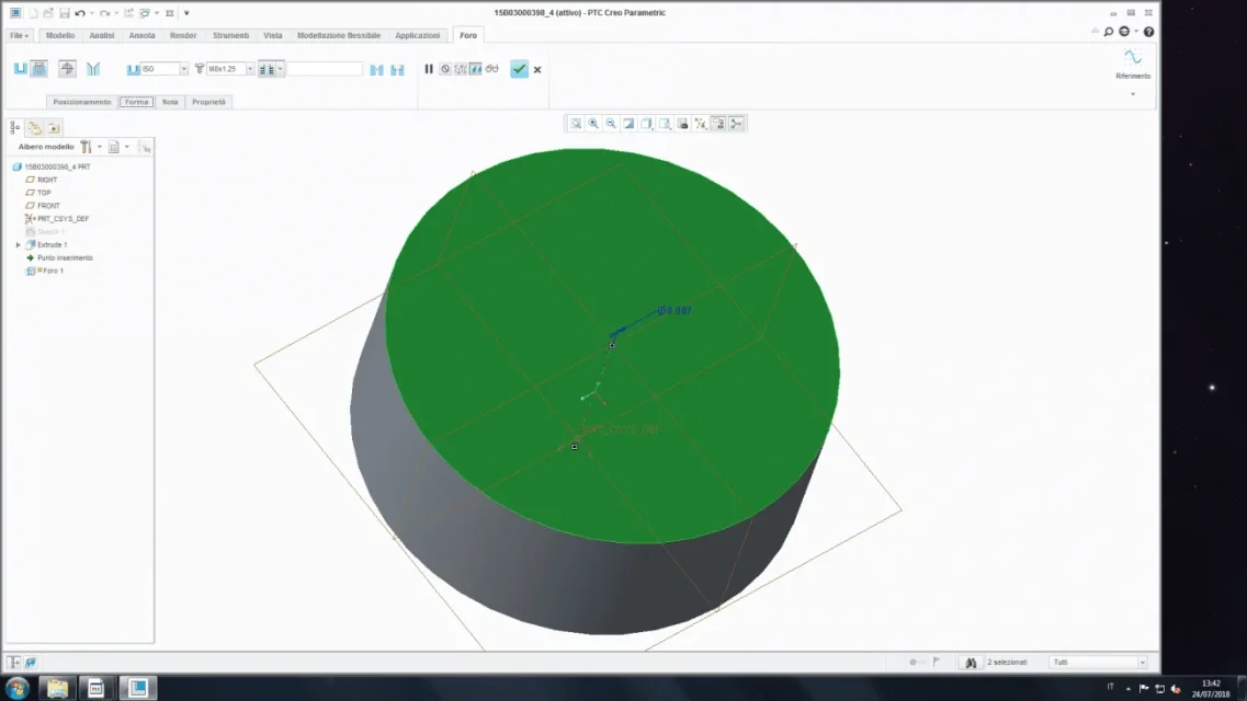

I am new to creo 3.0, I can't make threaded holes.
using the command "hole", select the icon of the screw, I choose iso, the size m8x1.25, posiziono on the face and axis, but when the position appears ø0.007, evidentmetne too small for a hole m8, and does not make me continue, or gives me error messages like "change the accuracy of the part making it less than 0.000...."

as you see from the image, the diameter of the hole is 0.007, although I have selected m8...
I have come to the conclusion that there is a conflict between unity of measure that I cannot find. I have set the configuration file with all metric units, but in the meantime in the thread properties it indicates "filetto per inch" and it's what stinks me...
I don't know where else to go and see to change the measuring system.
Okay, I got it.
for posters: was a problem of unit measurement: I had thumbs left in "prepara file" and mm" in the configuration file. after uniforming all the threaded hole came well.

the inconsistency solves it by making you start-parts, i.e. parts and assemblings without solid mathematics, but with all set parameters, when you start a new file, instead of starting from scratch, start from one of these.
