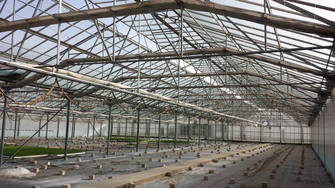

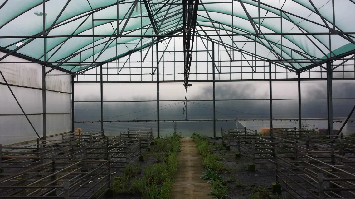

allego 2 files, so the photos speak from themselves.
1 hectare of greenhouses has roof to canvases, 1 hectare to glass, but for the rest extension, heights and various sizes are equal.
Angel.

What do you have in your hand over the photos? What do you know about the program? Do you have dwg of the structure?
banally: draws the front view span, extruding tot, repeating n° times with known distance.
If your partner can use the program and they need the encumbrance that structure does it in half an hour... .
I have complete photos and relief. I did the dwg of the plant, but the procedure you indicated me you know it in sw, so I will proceed like this.
