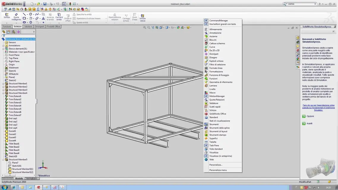

thanks lelepanz for the answer. in the premium in the "instruments" window I see only xpress. Where should I find the full version?
if in the command manager click with the dx does not appear a series of boxes to "activate" with a check? I go to memory but the box you care about is "evaluate." then you find simulation (I always wash in memory).
here's what I see by doing dx key on the command
found!!! Thank you very much...but I still have little familiarity with the program. Now I'll try with some post-books and see what I can do. Thanks again
