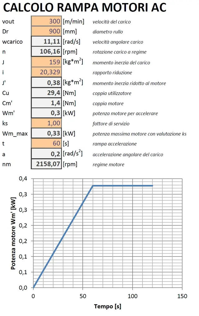

My problem today is the verification of a reducer to bring a cylinder-vapore in rotation.
data are:
vinyl =0 m/1
vfinal=300 m/1' (which then would be the maximum speed of the line)
m cylinder = 1090 kg
øest=900 mm sp.12 mm
t (time to get from 0 to 300 m/1')=60 seconds
the gearbox =20.329
ix (calculated by solidworks)=159 kg m2
I'm afraid I'm not an engineer, so it's definitely a trivial calculation for you, but I've been counting since yesterday, and I've been out of the most absurd results! !
I used canonical formulas, but something doesn't fit.
please tell me the couple I need out of the gearbox and the engine power.
or better could you tell me the correct formulas to use?
Thank you very much
