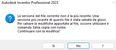

I would like to open the old version of the axieme (assieme.0001.iam). the following messages appear in sequence in the opening of the file:
continuous with ok
continuous with
again
at this point opens the file together.0001.iam but it is not the old version (instead of there is the part.0001.it there is the part.ipt)
