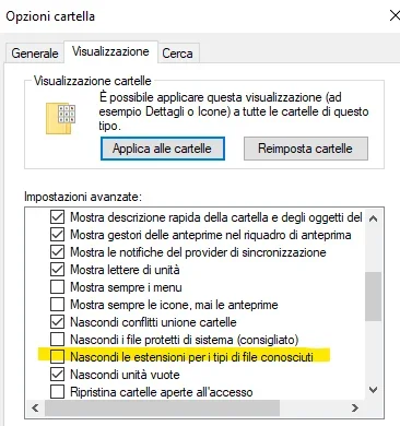

Hello everyone, I tried to search the forum but I don't think I found anything like that.
use inventor 2023 and I have a problem related to saving ipt and iam files.
in practice if I try to save files with a name formed by an alphanumeric string that ends with a point and with 2/3 numbers the name of the saved file is truncated before the point without warnings.
I give you an example:
if the name of the part must be xxxxxxx.123 or xxxxxxx.12 I find myself in the rescue xxxxxxx.ipt (o) xxxxxxx.iam if it were a set)
the only way I found to overcome the problem is to manually add the .ipt or .iam extension when entering the code, which is very uncomfortable since with all other programs it does not happen.
Have any of you ever had this problem?
can depend on windows (although it only happens to me with inventor)?
thanks for the attention.
