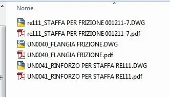

Good morning to all,
Attached I put a word file with ilogic code used by us usually to extrapolate the set of tables of a set (pdf+dwg) and its components. the only problem it presents is that I would like to appear in the name of the dwg and pdf files created not only the name of the code of the part to which the design refers, but also the description of the part itself, so that we can quickly recognize even without opening the design the part to which it refers.
