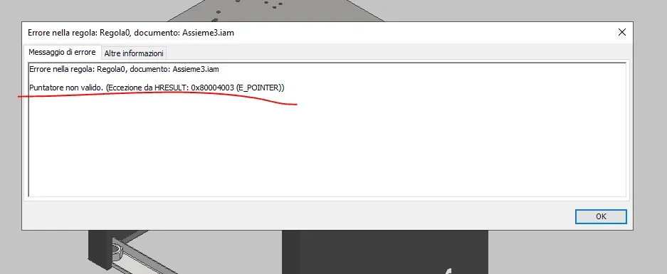

Hello everyone,
I downloaded the zip file and entered the rule in inventor but when I run it always gives me a set of errors (unrestricted pointer etc...) use inventor 2018 and until now I had never had prob. can someone help me?

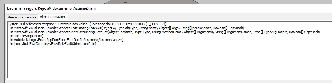

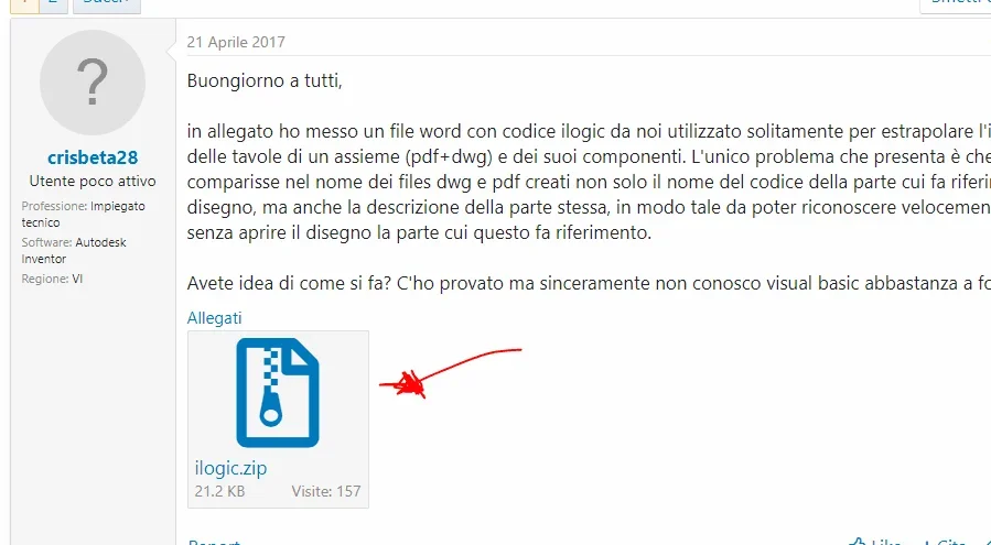

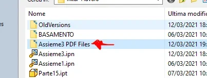

I also reported the change to the first rule1615572149432.pngDoes that unique thing even work for me??? Do you know how I can delete the creation of zip?? ?1615572261092.webpthe rule creates a folder that calls as a red arrow " and can make it call so nameassieme ok and then pdf-dwg "assieme3 pdf-dwg"
