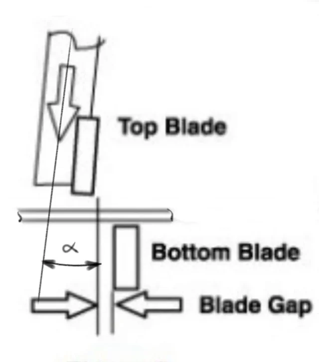

I would personally have a good indication of being on as regards alpha, which is the main cutting angle.
the angle of strip delta, the higher and the less the primer needs during cutting.
for a precision cut it is good that there is the primer. Screenshot_20231015_180902_Drive.webpin the image above there are the recommended values that you find on the tracking and shearing manuals.

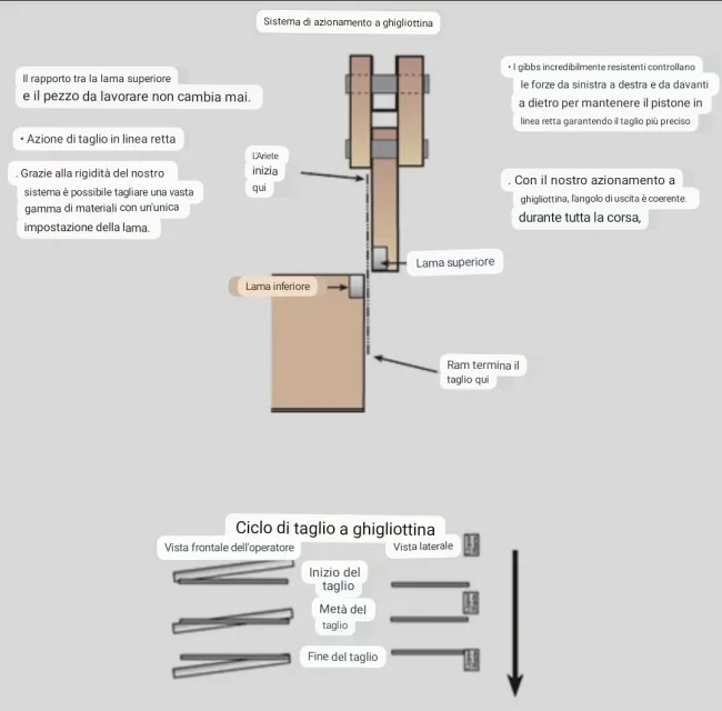

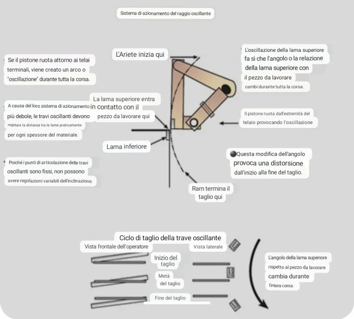

to bring some differences between the shears rising and descending straight from the curvilinear, here are two inmages:1697485056723.webp
1697485071438.webpclearly that if we have to do so many cycles, we will have sensitive advantage with the curved system at the expense of the well-finished edge.
