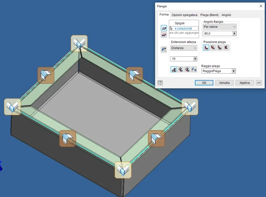

politely how do you do with inventor to make a box edged in sheet metal where the edges superior to and b are different? Thank you.

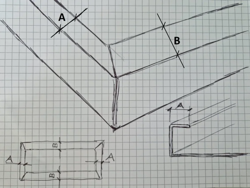

Sorry, but yesterday I couldn't put the sketch in. in practice when I make the second bend at 90° a and b but of different measures I can not while with equal measures (at 45°) I can.....A hand scarab?
What do you mean, "more"?esatto ma in pi
I'm sorry, but I got the incomplete answer. Anyway, if you look at the sketch I sent you, you know, thank you.What do you mean, "more"?

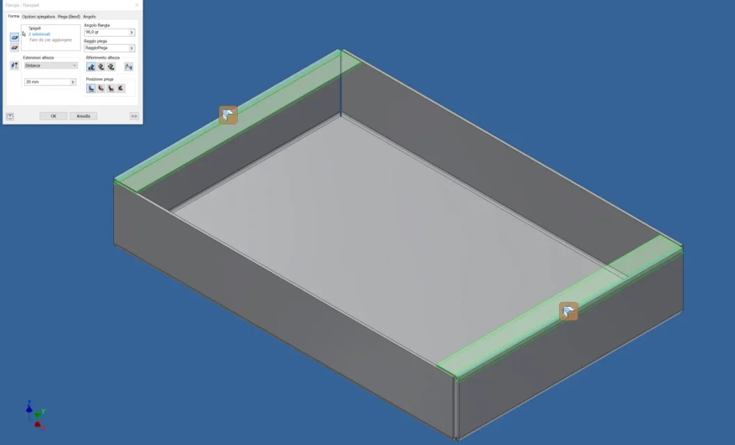

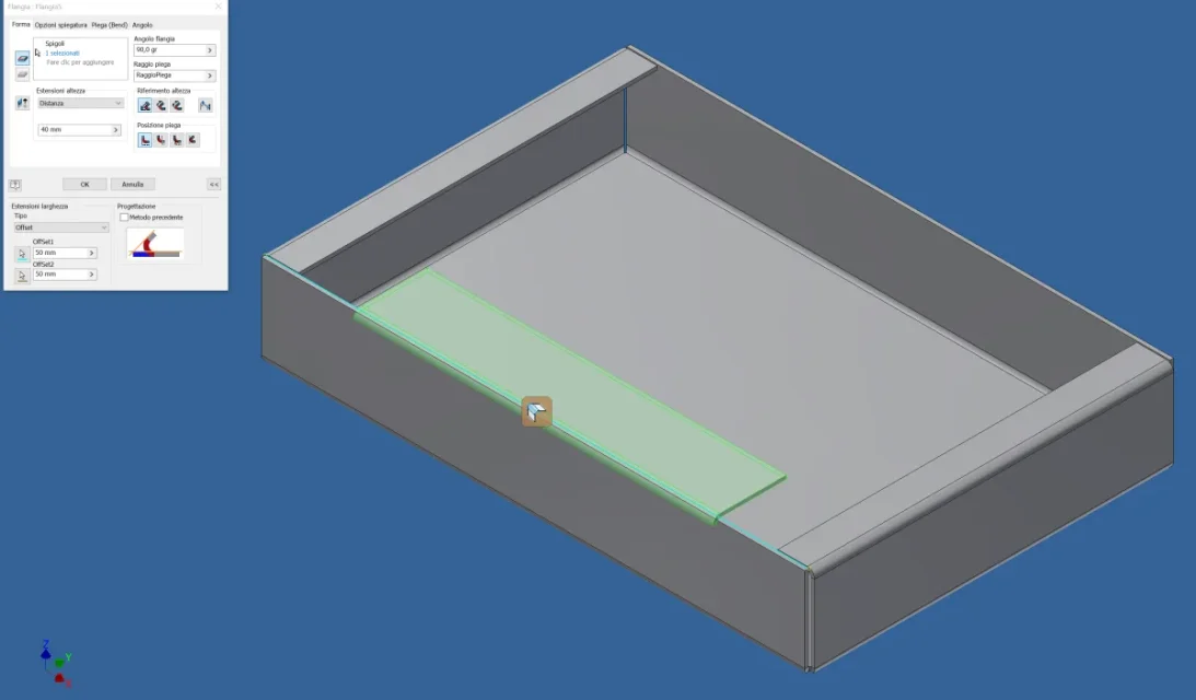

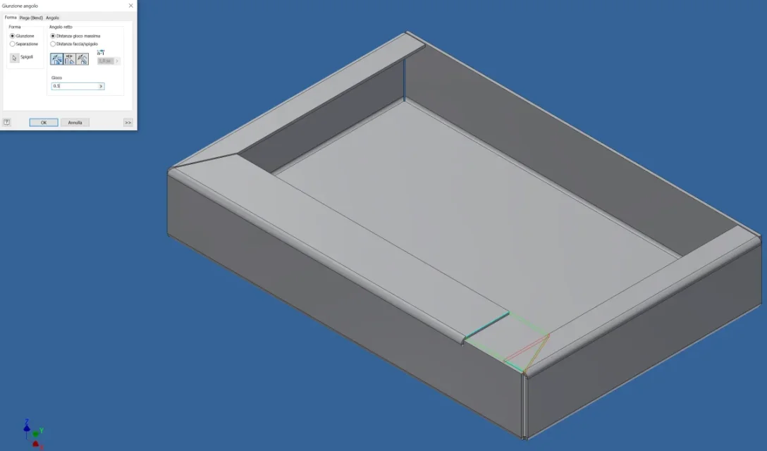

The video I sent you seems like the solution to your question.
