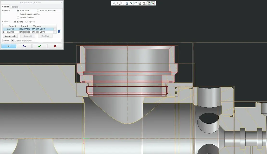

Here, just for completeness, in the phase of analysis global interference I detect an interference in correspondence of each threaded coupling modeled as described. It is peaceful that it always happens according to me with this method, because from what I have understood both for the tree and for the hole to extrude the diameter corresponding to the "big line" of the table of the component. therefore, in the light of this, what strategy to take to perform an analysis interference more faithful to reality? every idea will be very precious! ! !
in the particular case that I show you it is cosmetic threads of type gas, where for the trees I used the fdu placed kindly from lollone and for the holes I created a traditional cosmetic by manually typing the value of the nominal diameter to represent

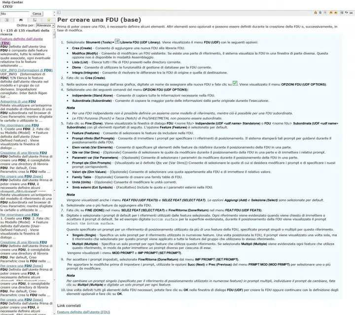

I've been using pro/e wf 4 for a couple of weeks, so I'm still at the very first weapons... I really enjoyed the lollone table, and I wanted to ask you how you can create .gph files. :confused: I would like to apply the user-defined feature even on the sunbeds, or on particular downloads. . .
I tried to search the forum but I didn't find anything.
Greetings:
I'm trying now, but I haven't quite understood the mechanism yet. try looking in the guide, it explains it well! the lion fdu I think it has so many variations how many threads are and they also manage here with the family table

I'm a little late
references are threaded surfaces and initial surface.
but in practical what are they?
are the outer diameter and the inner diameter?
and in case I have to draw them first as extrusion of two circumferences?
I'm a little late
hi Armalenta, new users are required a presentation to the community and reading the regulation.
You should also indicate which version of pro/e or creo you use, since in your profile you say you use autocad.
for your question... what do you mean, the thread cosmetic?
If so, in the case of the hole the fillet surface is the cylindrical surface of the pre-light and the initial surface is the plane from which the thread begins.
in the case of a pin, the thread surface is the cylindrical surface of the pin itself, the initial surface is as for the hole (starting plan of the thread).
