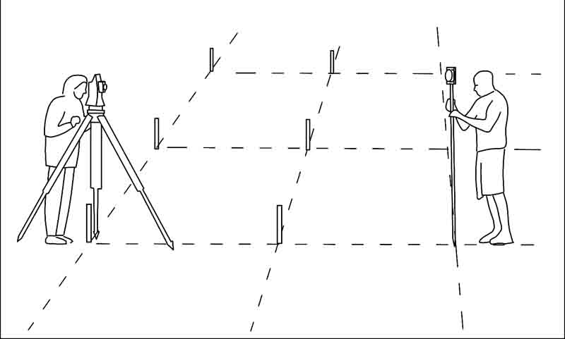

no tristus, the archaeological relief even if you do topographic relief we say normal, leaning to the trust points, trigonometric points, making a sowing of points to define level curves etc. etc., here is all you do to say wide extensions, you have to apply it and concentrate in a reduced portion, and it has to be decidedly precise and detailed, you use the miniprisma of maximum height 10 cm total, or the adhesive
do the topograph, but in a very detailed way, the jokes that were made in the yard were like the threats, "" I move that stone and you are forced to redesign it"" to demonstrate how much you have to be dotty, or the joke to the rod turn when before you make the general relief with normal rod and we found maybe in the vicinity of the sea was to say to the boat, that he had to go in the "batch"
here is a great we say manual excavation and archaeological relief
so you can see from those drawings above you have to be folded all day, instead with a "aircraft" like the one described and for every square put at least 4 points, the photo realized and with raster design and with the coordinates from topographic relief you straighten the photo and drawings the excavation, pier46 with the graphic tablet more or less I think it drew the same, with the graphic tablet i.e. autocad overlay now raster design, anyway with autocad 14+cad overlay I think that version for archaeological relief is the best compared to today's, (personal speaking) however now you have raster design that is fine the same and still you have only that! ! !

Perhaps I have not explained, the relief is generally framed in c.t.r. 10,000 and if possible in a scale greater 1:2000 or 1000, even in the catastral if it is for this, but the real work is precisely in the 1x1 meter squares, and no matter how the extension is, is that the work, the time to employ. . as he said eistein is relative ..., an illusion, that in this case for a dig you can take years to make drawings, it is not a relief of a zone built to the expansion go and you take the points that profit you, when it is precisely from ricxxx and before the advent of the pc they did everything by hand, there are drawings that just beyond the excavation you see the artistic hand and the detail to which some However a fascinating world, as said on the subject for them would suffice autocad 14 e autocad overlay for work to do, however it sketch You can only use it if you have a surgeon's hand, I used polylinea and since I could do the zoom I made the polys very close to the right points, now you have the grip first not, but if you have speed you always do it with the old polylinea system not with the spiline, and then you set up, you do it first time before you set up the drawing later.
