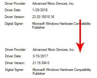

Do this test... do a search through windows update or via device management
So, yes, but something curious happened: the drivers were "downgraded" more than the opposite
don't mind the important thing is that everything works properly... do a specvieperf 13 test. I've never had any problems until today. Let's cross our fingers.
