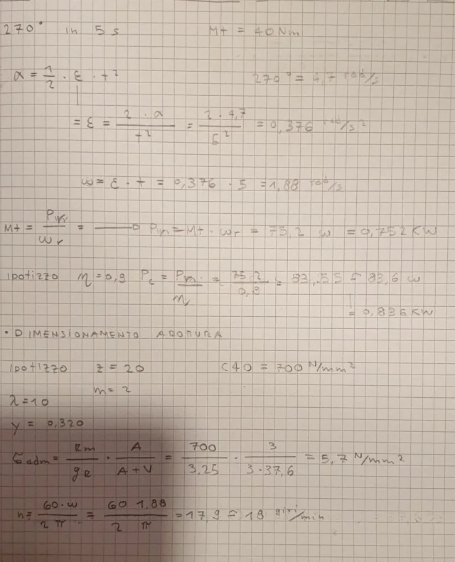

What's the acceleration to?
- 270° : 5s = 360° : x ....make the reverse formula and I find that x=6.67 seconds/turn
- to have the spins/minute that is n you do simply 60minuti/second divided 6.67 seconds/turn to find 9 turns/minute
- to obtain omega ....2*pigreco*n / 60= 0.942 rad/s
Why do you make up the formulas? are the usual formulas of number laps, angular speed that are always used and everywhere, at work and at school.
equal torque multiplied angular speed....40nm*0.942=37.7w which divides the 0.9 yield get an input power of 41.87w.
Why is the degree of breaking safety worth 3.25? Why so and not 3 or 6?
It's all in the wrong waterfall.

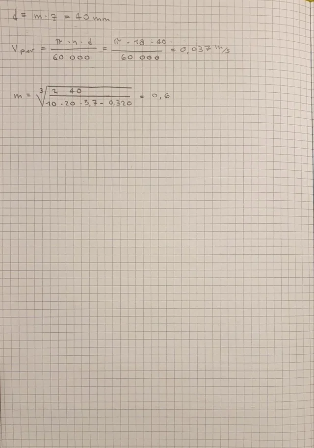

c45 normalized or bonified expanse, which has the highest breaking load of the c15 charcoal or wired or hardened to heart? then always indicates that treatment you do it and the basic material if it is filled, tempered at heart etc. do not be summary.
Also in the last form consider 40nm....but if you lose power and torque....you must insert 40/0.9=44.5nm
then write: "I'll have m=2..." and then you'll come to calculate "m=0.6". conclud....write 0.6 less than 2, positive verification. do not throw in numbers and formulas.
and you even had different tricks before, dispenses, calculations, etc...
