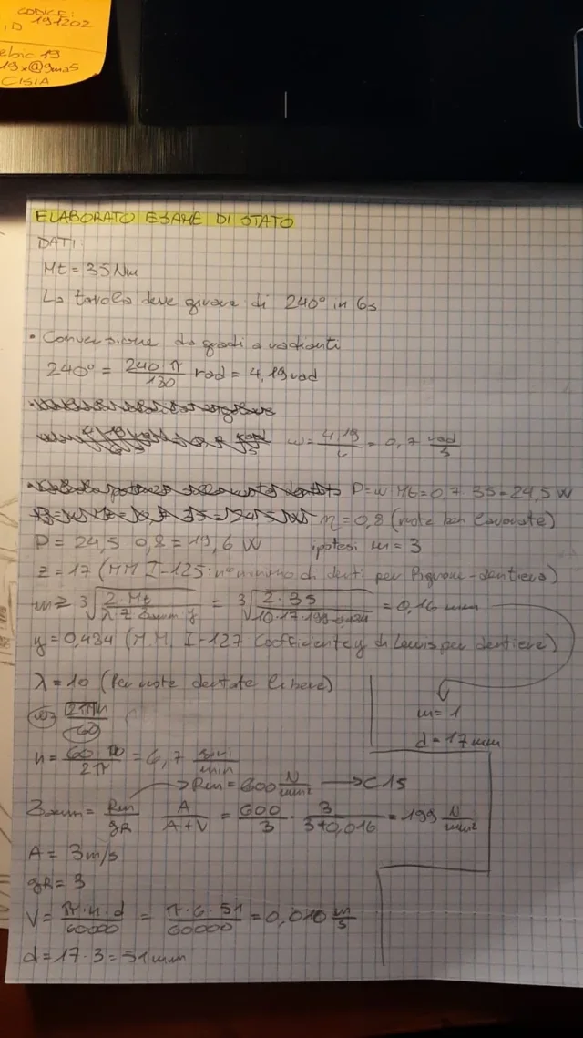

good morning to all, can someone help me in this design? i find myself with a professor who cannot help me do this exercise

you think about it, but the whole class is struggling. my professor treated the subject only for five minutes, not even making us a sizing
I'm sorry, I don't want to insist, but the gears made them? how do they measure and verify? as you said before yes.
here now, it is not a problem to apply lewis .... but understand that 270 degrees are not a turn and therefore development is not a primitive diameter round. . .
that puts us 5 seconds or 70 seconds doesn't need anything in this exercise....unless you check it hard and wear according to norm and impose a number of hours of operation....but I don't think that's what you're asking...unless you know the whole subject.
I must also do the fatigue dimensionalization and in this case I must use omega that is obtained from the angle in radiants, fract the time in seconds.
