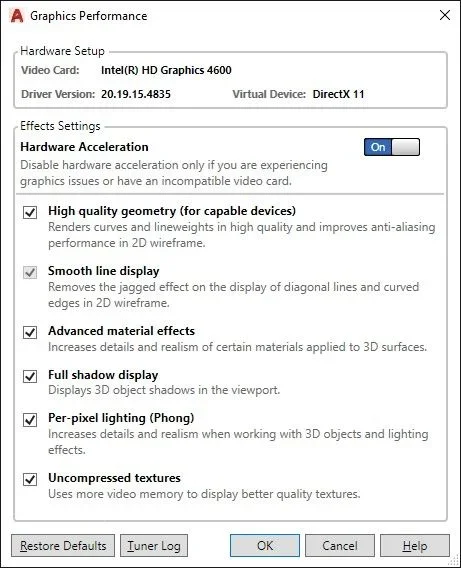

I have a correctly installed firepro w5000, but if I launch the 3dconfig command from my acad2017 I see the enclosed window, it seems that I go to use the chipset integrated in the mobo
Can you tell me how I can use the discrete card as the first choice?

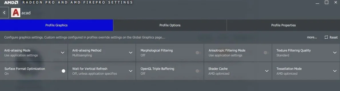

then go to the radeon pro settings panel and assign autocad as software to feed to the w5000.
Is there any particular setting for acad?
It's better, even if there's still a little bit of shooting.
the graphics card in use now is correct
Move the mouse and the cursor moves to snaps, especially just after you start moving it
As far as the drivers have just left the new drivers for the w5000 I suggest you update them.
