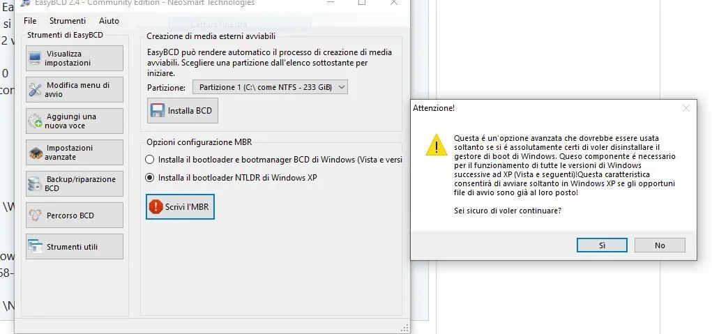

when configuro easybcd 2.4 exits this list (which seems correct):
there is a total of 2 entries in the boot manager.
default: microsoft windows xp sp3
waiting time: 30 secondsdisco di boot: c:\
entry #1
nome: microsoft windows xp sp3
id bcd: {default}
unità: d:\
percorso gestore boot: \nst\easyldr1
entry #2
nome: windows 10
id bcd: {current}
unità: c:\
percorso gestore boot: \windows\system32\winload.exe
Then he asks me "install win xp ntldr bootloader" an exclamation point with writing "write thembr"a notice "... this advanced operation manages the boot of win xp.... etc... Are you sure you want to change it? " something pressure no (I'm not sure :rolleyes:)
Maybe the mistake is here? disco di boot: c:\ (win xp is on d in fact)
entry #1
id bcd: {default}
unità: d:\
entry #2
nome: windows 10
id bcd: {current}
unità: c:\

Hi, I haven't solved yet. I find myself in this situation:
1 hd with installed and working xp
1 hd with installed and working win10
if I connect a hd at a time (i.e. a connected hd and a disconnected one) normally turn on and independently operating systems (and are working).
I installed on win10 easybcd 2.4 (except for mbr modification requests that I don't know if to press yes or no) because on xp you don't install.
the result is the notice of "modification" (see photo)... that "if" I have to press ok without risking anything... I do.
Code:
c'é un totale di 2 voci nel gestore del boot.
predefinito: windows 10
tempo di attesa: 30 secondi
disco di boot: c:\
entry #1
nome: windows 10
id bcd: {current}
unità: c:\
entry #2
id bcd: {e08b1111-6168-11eb-a9fd-f46d04e513e1}
unità: d:\
percorso gestore boot: \nst\ntldr

I wanted to avoid "passing" for bios hoping to use xp win boot or win10 boot or easybcd... I just miss how to configure easybcd... This is my doubt.. doubt that on the net is "powered" confirming that un boot between xp-win10 is not so obvious/simple to do How do you think...
30 seconds time to "choose" what operating system to start at every start... I thought it was easier to tell the truth.
