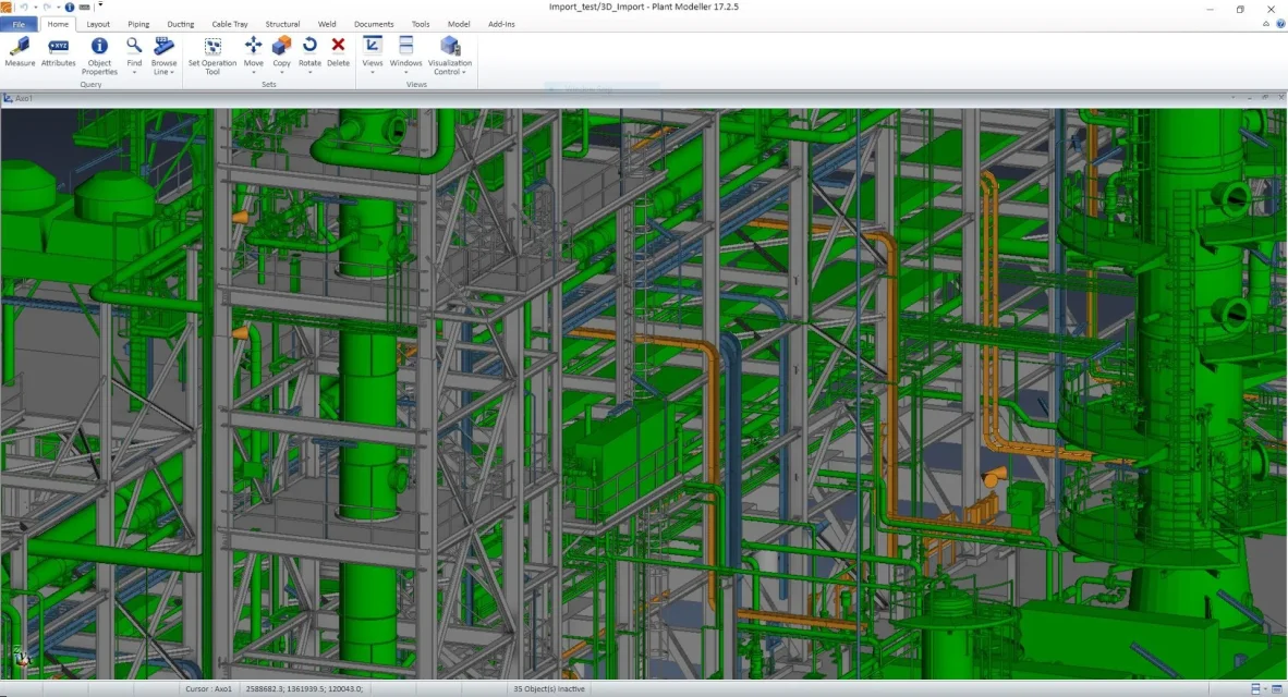

advantage points in using our system? here they are listed:
- distributed modelling on multiple integrated locations natively in the software without additional costs and without complex administrative activities
- performance of the graphic engine unknown to other systems that allow to import any mechanical format (not a limited set of formats!) or model from other systems (such as those of had and intergraph) without geometries losses and with presence of all the data of the same then editable, here is an example:1pdmsin.webp

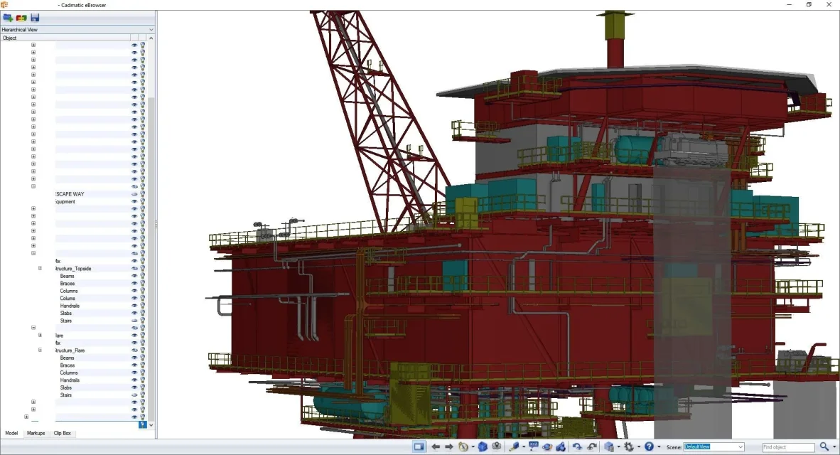

- compatibility with projects requiring bim and possibility to import and export models into ifc format- review system (downloadable and tested for free here: cadmatic ebrowser) and sharing of the model that allows to avoid further aggressive costs having to equip itself with the Naviswork navigator, that allows navigation and interrogation of model (also imported) with considerable fluidity and visual quality, as below:3.webp- use of the clouds of simple points and without impact on performance during modeling
